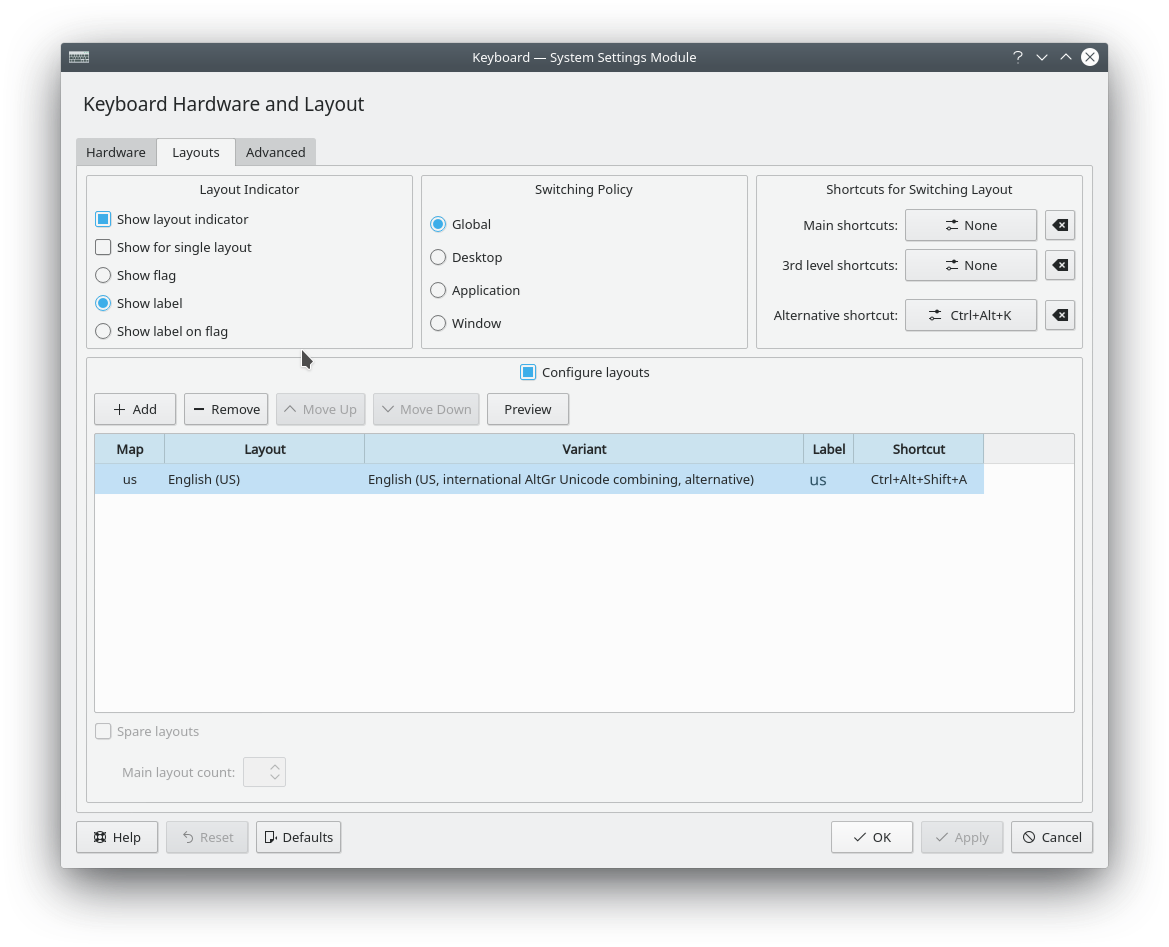

Stop this insanity and use "English (US, alt. intl.)" as your keyboard layout Big Grin
An even _better_ solution!
(11-18-2018, 12:20 AM)Noxmiles Wrote: Stop this insanity and use "English (US, alt. intl.)" as your keyboard layout Big Grin
oh my god
thank you for saving my life.
For future reference, this is what I set my keyboard to so the apostrophe was the correct one. At least for me.
Layout: English (US)
Variant: English (US, international AltGr Unicode combining, alternative)
