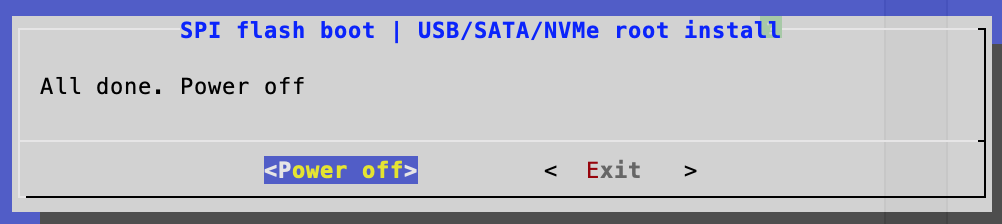

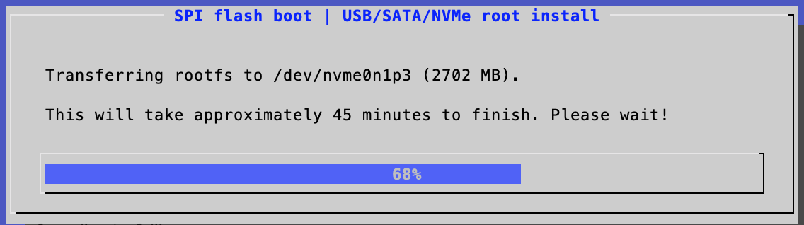

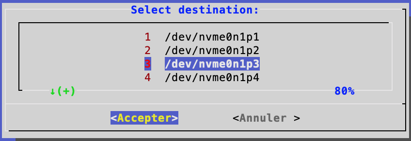

I have selected the option 6:
I have selected a partition on the NVMe:
Then the copie was running:
And finally:
I removed the power cable; the eMMC;
I putted back the power cable and then... nothing excepted the power green LED and the RJ45 port LEDs (I have waited for severals minutes but still...).
