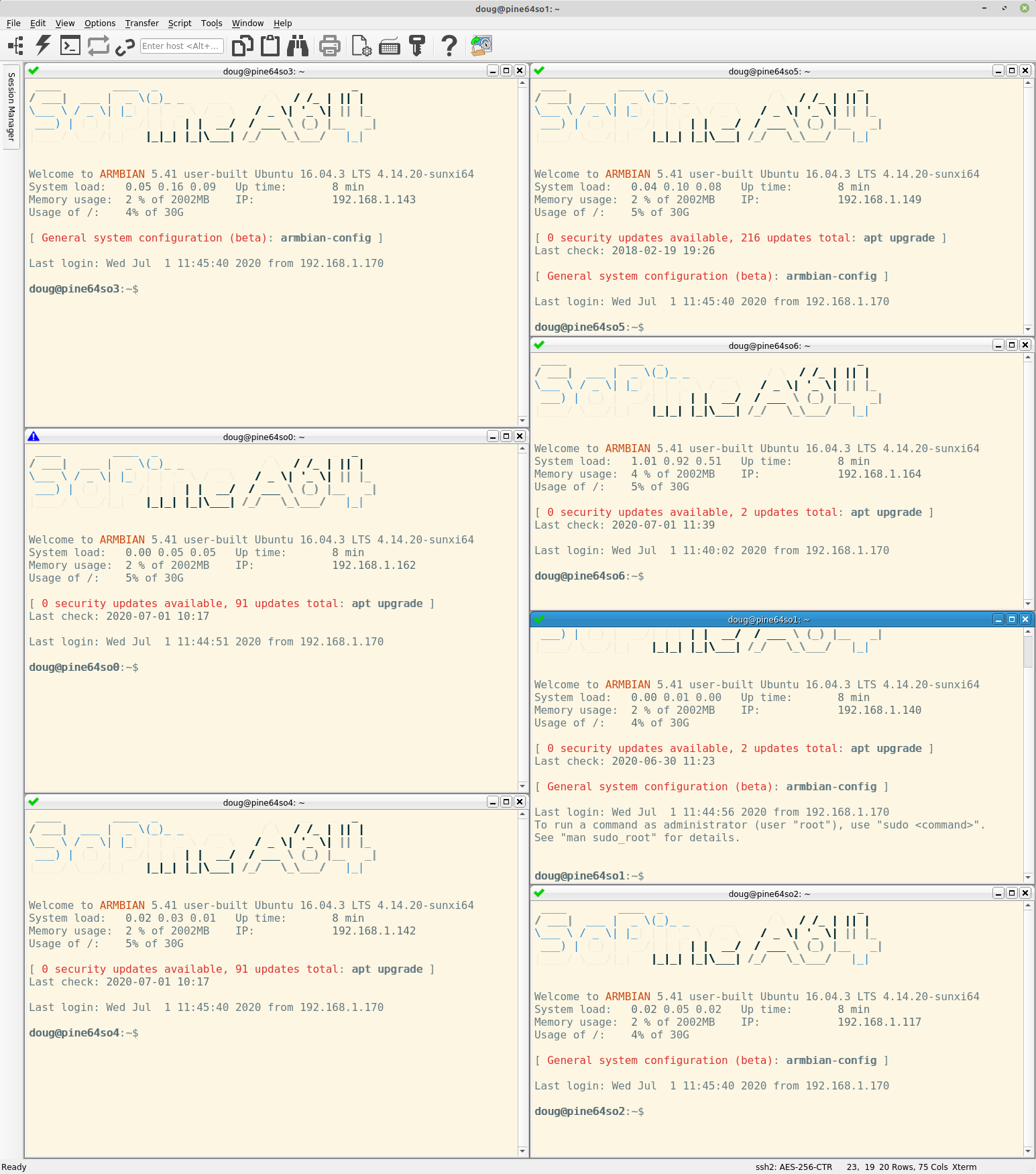

Oh Joy!! Finally I have my modules booting. I am so happy. And I am so appreciative of your effort to get this information to us. I have been struggling with this and it has been keeping me from enjoying my ClusterBoard for several weeks. I am in your debt. :-)
My sincere thanks to @aww  for the image which finally worked in my cluster.
All seven modules up and happy, yea!! See the attached image.
.png   cluster-up.png (Size: 436.33 KB / Downloads: 504)
