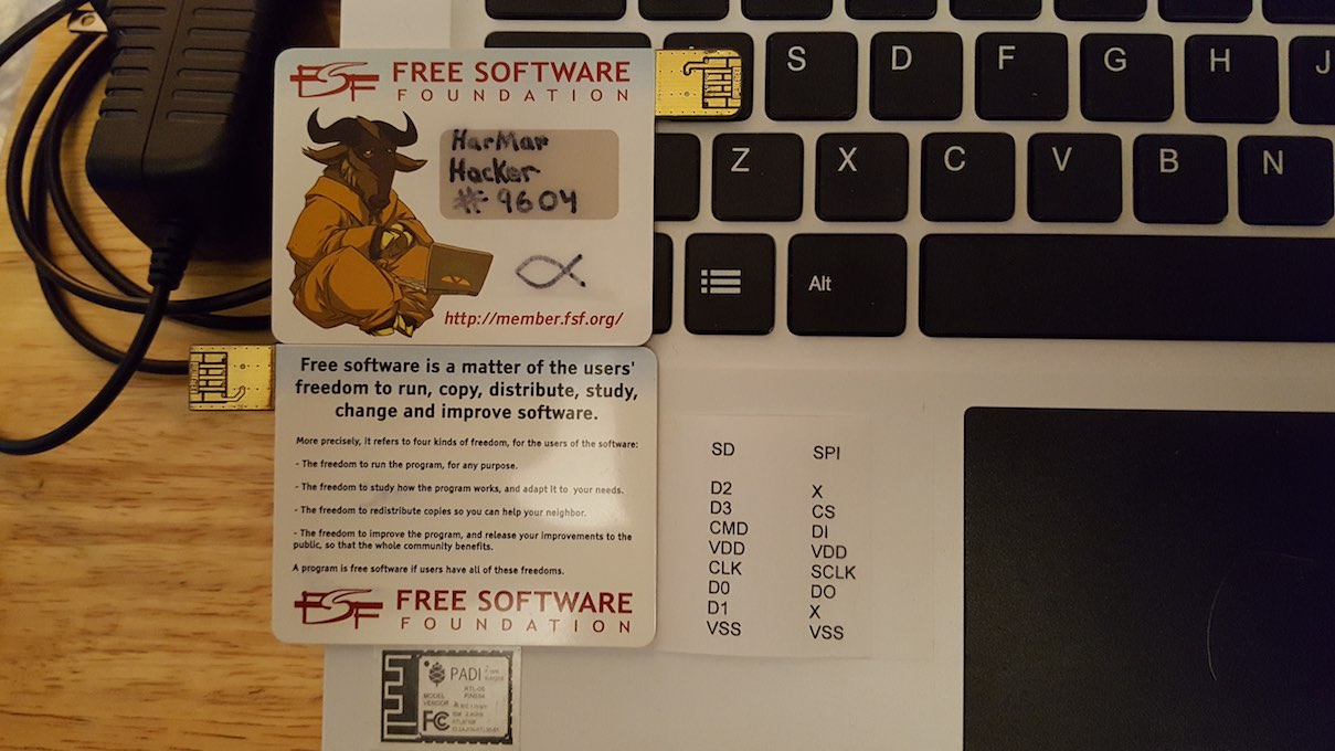

You've heard me mention in the past that I'm a card carrying member of the FSF;  well, in the pic above you can see the cards I'm talking about laying on my Pinebook keyboard!   I am FSF hacker #9604;  and when you're a hacker with the FSF your membership card is an official usb boot stick !   ... in this case, my cards ( you get to see both sides ) contain Trisquel Linux a completely free blobless OS gnu+linux system.
And now to emphasize the point...  in the classical sense of the OPs question ( and many have this question ) if I put my membership card ( FSF ) into any one of my notebooks I can bootup Trisquel Linux ...  well, except for my Pinebook;  because these cards will NEVER bootup in the Pinebook -- not now nor in the future ever !
