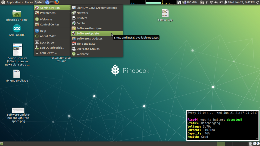

This post is here to document a known issue which most likely stems from an odd requirement of the graphical Software Updater tool used in Ubuntu. It's not new, nor is it unique to the pinebook/pine64. It has plagued other SBC communities, even the mighty Raspberry Pi has suffered from it! Wink So, the Software Updater tool runs contently in the background, checking for updates. Or you decide to run it manually... you remember where it is, don't you... it's here:
So, either you run it manually, or it suddenly tells you there are updates ready to install. So you dutifully click the 'Update' button, only to be greeted with this nasty error screen.
What did you do wrong? Absolutely nothing. For some bizzare reason, it expects that /boot has at least 48.2M free (this may not always be the case, but it is the typical number). And since the boot partition is 50M in size, with 23M used on my own system at the time of writing... the 28M of free space just doesn't satisfy it.
