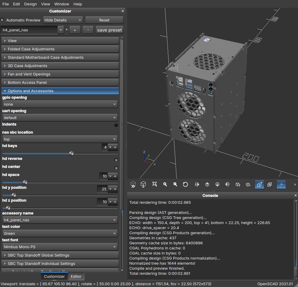

The first is a NAS case with a tool-less panel design that can be produced with CNC cutting machines or 3D printed.  Both 2.5" and 3.5" drives are supported but 2.5" drives use a 3.5" to 2.5" adapter.  If you don't have adapters one can be printed using sbccb_accessory_tool.scad
Nas Case Features
- Top or bottom rear SBC position
- Wide SBC support
- User adjustable xyz case dimensions
- Mixed panel thickness
- Up to six 3.5” hard drives
- Drive positioning and spacing GUI control
- Forward or rear facing drive orientation
- Front, top and bottom vent cover patterns
- Rear fan(s) positioning and spacing GUI control
- Part sections for CNC production, DXF or SVG

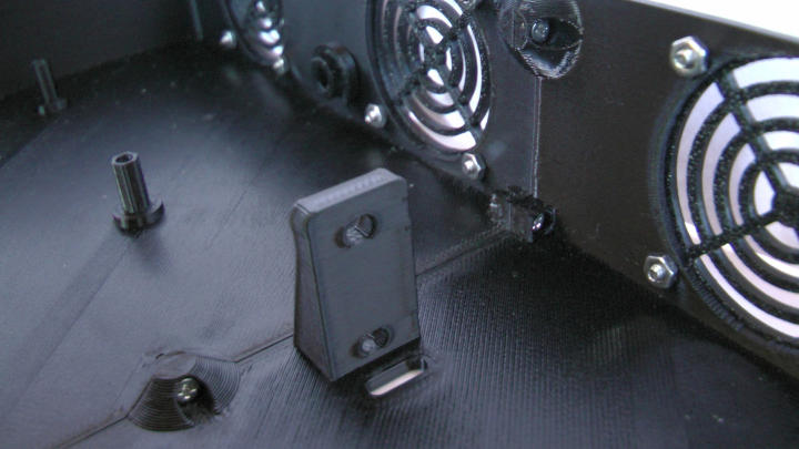

The Rack case has many options and can produce a variety of rack bays in either 10" or 19" width.  There are brackets available to make a table top stand for those who currently don't have a stationary rack.  Shouldered washers that use 3mm hardware can also be printed for use with the table top stand.  Both are available in sbccb_accessory_tool.scad.

The rack cases are divided into approximately 150mm wide parts for printing and use M2 hardware for assembly.
