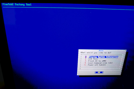

- rebooted and got this:
        [Image: attachment.php?aid=2795]
When I choose 'Load Command Line (sh)', the root of my system is the second partition on de SD-card.
