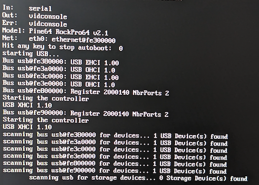

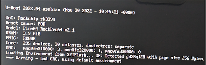

This would boot u-boot when the SD card was enabled but would fail to go further.
If I had the emmc installed (uninitialized) it would complain about that and then start a PXE boot loop.
If I remove or bypass the emmc, it complains there is no partition found on MMC 1 (It is looking for MMC1:1)

(Edit: Just for grins I tried an edge community build of armbian and same exact thing even though the uboot was 2 months newer)
(Edit 2: breaking out of u-boot and running "mmc part" returns "Unknown partition table type 0")
