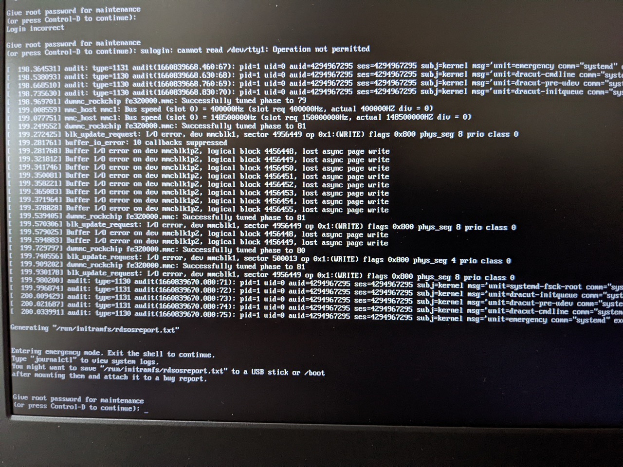

In trying to flash a new copy of the OS using dd, I did indeed "destroy disk". So now I cannot even boot to SD. Ordered emmc-usb module writer from china so hopefully that will get it up and running again.
Attached is the output displayed when trying to boot from SD with no emmc installed.
