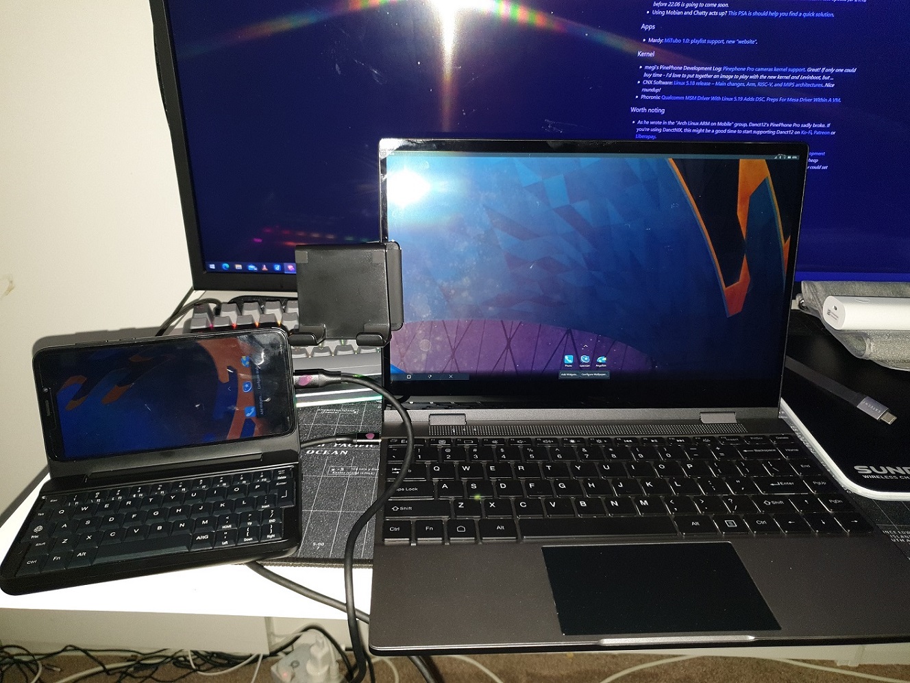

for the lapdock i am using the Uperfect X lapdock  its practically the nexdock 360 minus one usbc port. the cables that came with the lapdock are from ugreen.

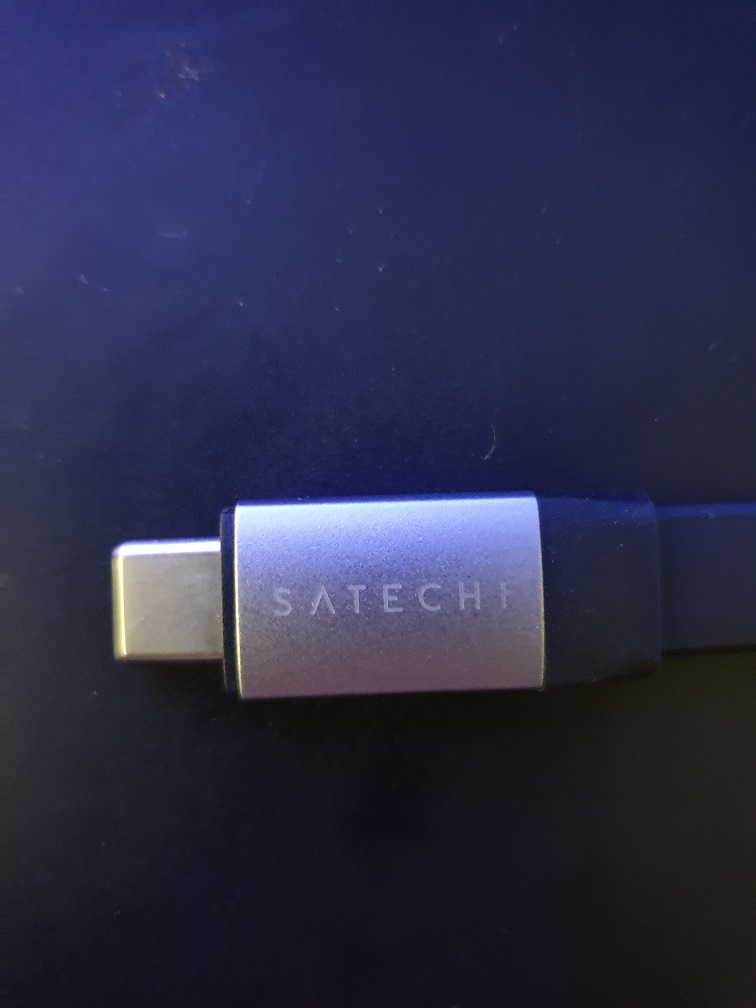

and the biggest thing is that cable orientation matters....  so once i  got the cables at each end in an orientation that worked. i added a simple dab of nail polish.  as to reduce future setup frustrations...
I also tried a Satechi brand short cable and it worked as well but only when the satechi logo is facing "out/towards the user"...
also i found that if things were not looking right after plugging in the cables  pressing the power button quickly to lock the phone, then entering back in via the login screen  usually fixed things....   for the most part i did not have to play with screen display settings just let plasma work it out..
like all things on the pinephone pro  its beta...
I will update this post with images soon   also  this setup works even when the Pine Keyboard is attached to the PPP...   but power drain is still a thing so until charging works better   it appears  even if plugged int  still drains down ever slowly 10-20% per hour whilst using it.....

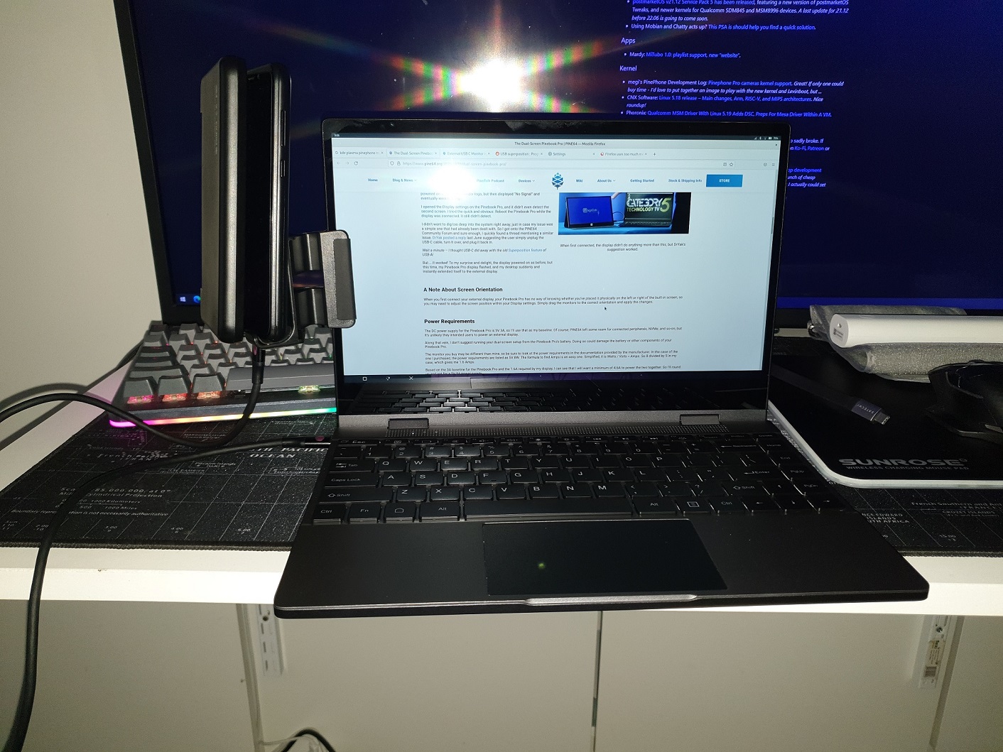

Just a further observation. in relation to once you get it working then you shutdown then want to set it back up again... i found it can be a bit of an art .... essentially if i run into any issue getting the lapdock to detect the signal / send one to the pinphone.... i usually find it comes down to having the phone at the lock screen "number pad" then i plug the cable in enter the lock screen code and wait to see if all is good. if it is not, then i change the cable orientation and rinse repeat usually within 2-3 tries ...
in reading through the pinebook forum for those that used external monitors it seems to be a thing that is experienced... from what i can gather, each device is setting which lane it is setting usb on and alt DP on and that can be the opposite between the devices, hence the changing the orientation of the cable until they are using the same lane etc.... it gets a little confusing because usb-c isnt meant to have superposition issues but the reality is different....

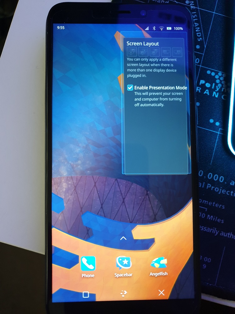

to also make things a little easier, for those using docks /  SSH or lapdocks  if you find the device goes into suspend mode while its attached to power....  there is a widget  that might work for you.
sourced from https://forum.pine64.org/showthread.php?tid=12909
I happened to long-press the desktop, and "Add Widgets" appeared
I pressed this, and tried adding the "Display Configuration" widget.
It had something called "Enable Presentation Mode", which I tried.
if instead your looking to change the timings then JasonG-FR in a post in the above mentioned thread explains what to change in the ~/.config/powermanagementprofilesrc file...
