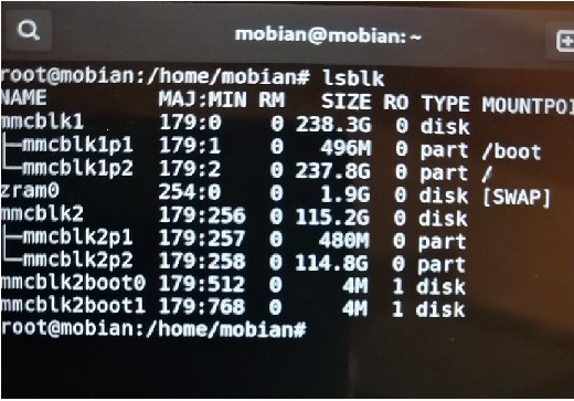

thank you, thats what i am currently doing but im using mobian and the poweer dosnt turn the phone on i have to press the back RE button + the power button a couple times the it boots from sd . i dont know how tho fox this issue.
this is what shows up when i type "lsblk"
(03-20-2022, 11:13 PM)Jdoe Wrote: Thankyou Phalio, cant boot my phone after trying to flash mobian to emmc i can boot the phone but every time it involves me pressing the RE button + power a ccouple times and then it boots from sd. i dont know how to fix this now lol. any thoughts?
I don't think Mobian works on the eMMC for now. Simply wipe the bootloader from the eMMC as explained under https://wiki.pine64.org/wiki/PinePhone_P...m_the_eMMC.
