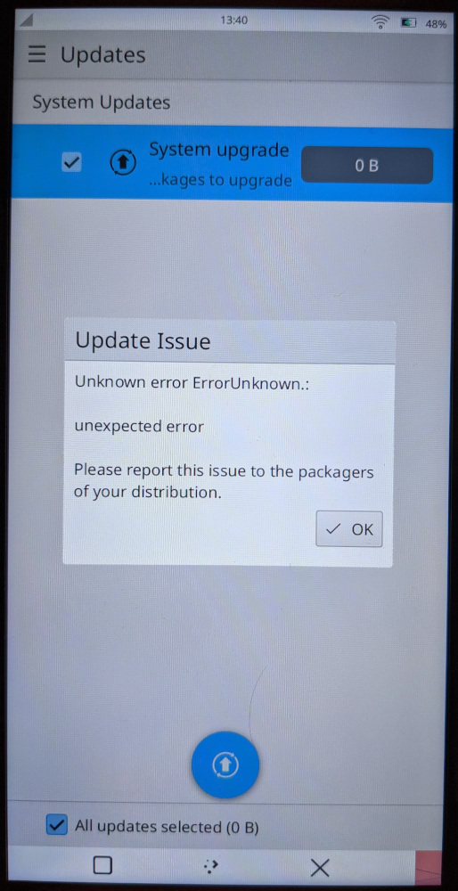

Just received my first Pro, switched off the modem, mic and both cameras, plugged in charger, connected WiFi and attempted to update/upgrade the soft:
Rebooted, tried again — same thing.
Note that the updates' size appears zero. Weird.
How to debug it? Can I try the same via CLI to see some details? Isn't this a common/known issue with new Pros?
