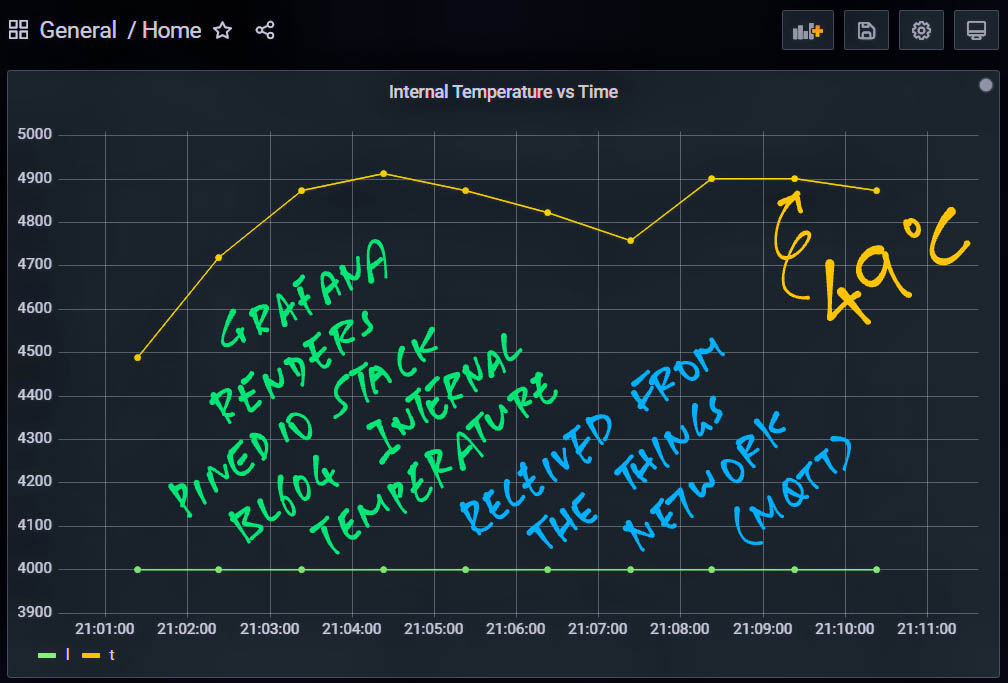

If this helps: Here is the Internal Temperature I recorded with PineDio Stack shortly after rebooting.
BL604 is mostly idling, and every 60 seconds it sends the temperature over LoRaWAN to The Things Network...

FYI: I have recorded the Internal Temperature over a 20-minute period, here's how it looks...[Image: 811a4407f25ba02bf3010a1f826ee67f.jpg]
