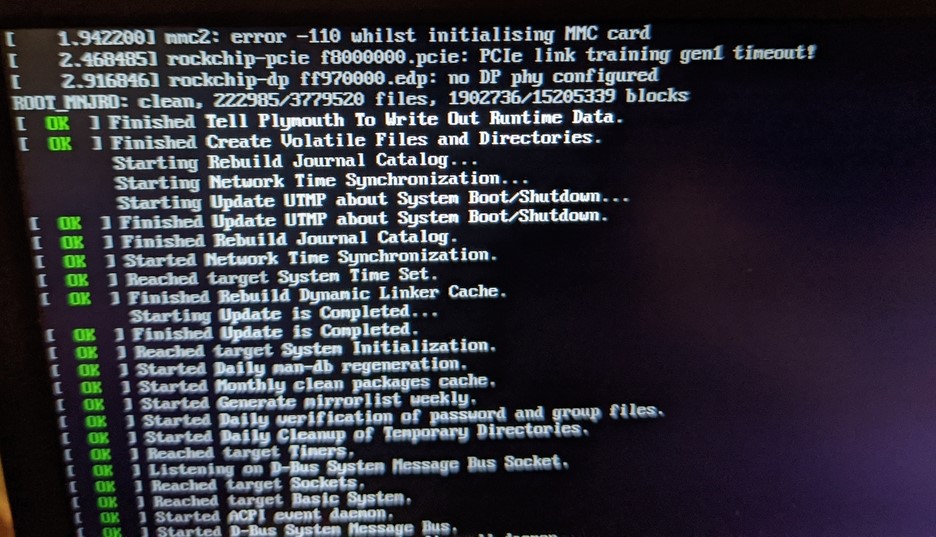

If I am using an EMMC to usb reader to flash. It is always recognized. I doubt it is a Hardware problem with the EMMC. The EMMC always makes it to uboot. My uboot is on the EMMC, and once I am in, it works the whole time.
I inspected both male and female sockets with a microscope and found some flux bridging 2 pins on the socket in the pinebook. Cleaning this made no difference.

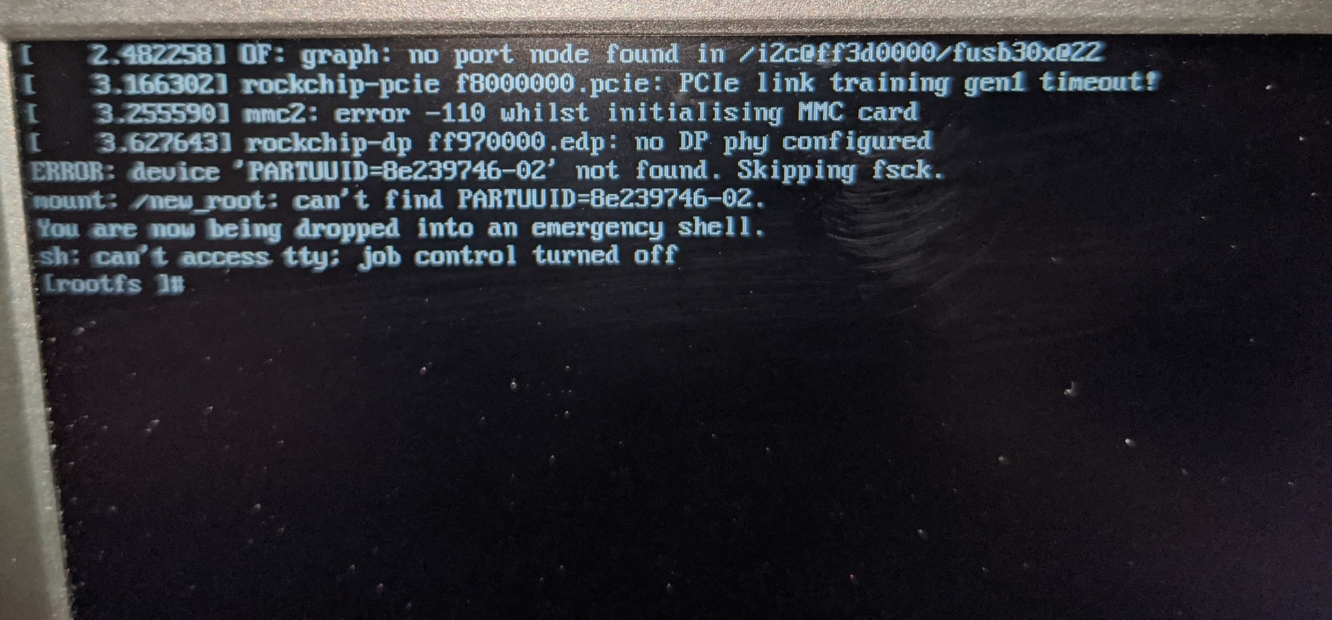

The BSP uboot fails for me 100% of the time. It will faill with only a single failure to connect the EMMC.
The most recent pinebookpro-uboot from the manjaro repo seems to work more frequently than the others, but still fails too often.

I am about to flash again, because I can't get past uboot with the BSP uboot I currently have installed.

Here are a couple of pictures. The success shows manjaro booting after a single error 110 with the manjaro uboot, and the bsp uboot failing after a single error 110. After a few boots, I will exceed 4 error 110's on manjaro and begin failing to boot.
