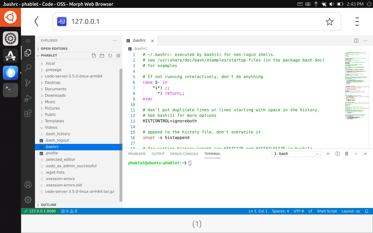

VS Code running on PineTab
... using vs code server and the browser.
> wget https://github.com/cdr/code-server/relea...m64.tar.gz
> tar -zxvf code-server-3.5.0-linux-arm64.tar.gz
> cd code-server-3.5.0-linux-arm64/
> ./code-server --auth none
browse to 127.0.0.1:8080

Do i need to do some steps before this? Because i am getting failures.
(09-12-2020, 02:48 PM)m.alizade7 Wrote: Do i need to do some steps before this? Because i am getting failures.
What failures are you getting? Just worked for me, not sure if other changes I had made prepared it to work.
if you cut and pasted, you may have got the abbreviated link that the forum software created
the full link is as below (but without the space)
https://  github.com/cdr/code-server/releases/download/v3.5.0/code-server-3.5.0-linux-arm64.tar.gz

 I am getting No Authentication & Not serving HTTPS.
(09-15-2020, 03:42 AM)m.alizade7 Wrote:
That sounds like what the server tells you when it is working properly (we told it to use no authentication did not request HTTPS).  Keep that terminal window open and change to the browser, then go to 127.0.0.1:8080 and that should connect the browser to the VSCode server and bring up the editor interface.

Sorry for a late reply, but I did it today and it worked!
