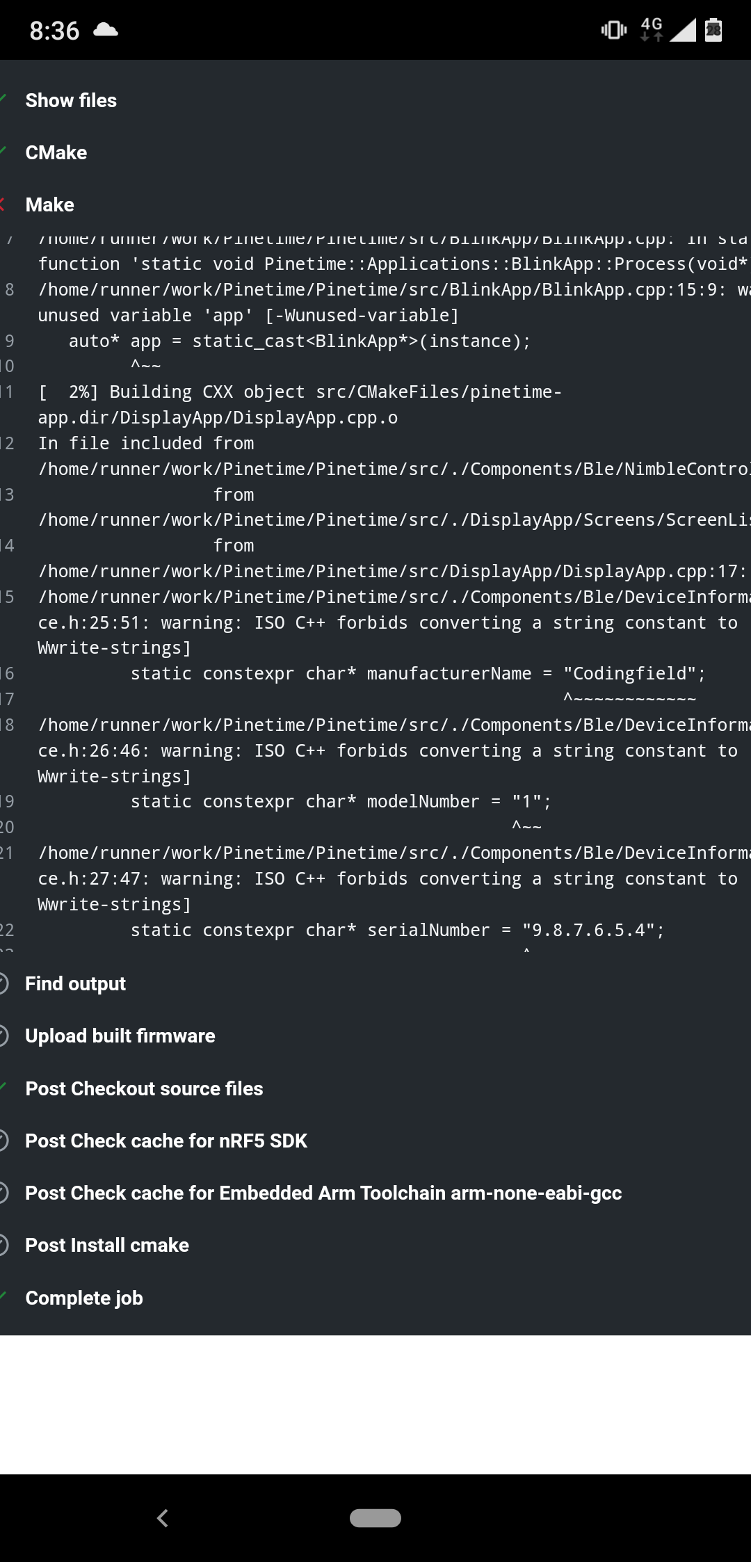

.png   Screenshot_20200727-203607.png (Size: 315.95 KB / Downloads: 491) Got an error earlier today. Sorry for the screenshot, I'm away from my Raspberry Pi.

(07-27-2020, 01:40 PM)tomthetaffer Wrote: Got an error earlier today. Sorry for the screenshot, I'm away from my Raspberry Pi.
[/url]
  Edit   Delete
Hi: Sorry about that... Can you try this fix:
[url=https://lupyuen.github.io/pinetime-rust-mynewt/articles/cloud#our-first-pinetime-firmware-build]https://lupyuen.github.io/pinetime-rust-mynewt/articles/cloud#our-first-pinetime-firmware-build
Look for "If we see this error..."
I'll work with JF to fix the source. Thanks! :-)
