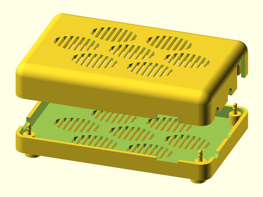

I've come up with a 3D printable design for a case for the Pine64.
This case design has a bottom half with feet and with pegs that
stick up to match the mounting holes in the board.  The top half
has matching receptacles that fit over the pegs for tool-less
assembly.  Vent slots are provided top and bottom, and access
holes are cut out along the sides for electrical connections.
The one I had printed fits the board perfectly and looks sharp!
You can download the design, including an ".stl" file for immediate
printing and the OpenSCAD source code by going to:
"https://spideroak.com/browse/share/brf_public/Pine64_Case"
See the included "Readme" file for more information.
I hope folks find this useful.

Yes, an STL file (with hole for power button but not GIO pin access) is packed
into the .zip file that you can download.  There is a read-me file in there, as
well as the OpenSCAD source.  Give it a read...
OpenSCAD is pretty easy to use, given the source files.  You can tinker with
the cut-outs without having to wade through all the code.  Also, for example,
you might want to print the two parts of the case as separate jobs.  Whatever.
