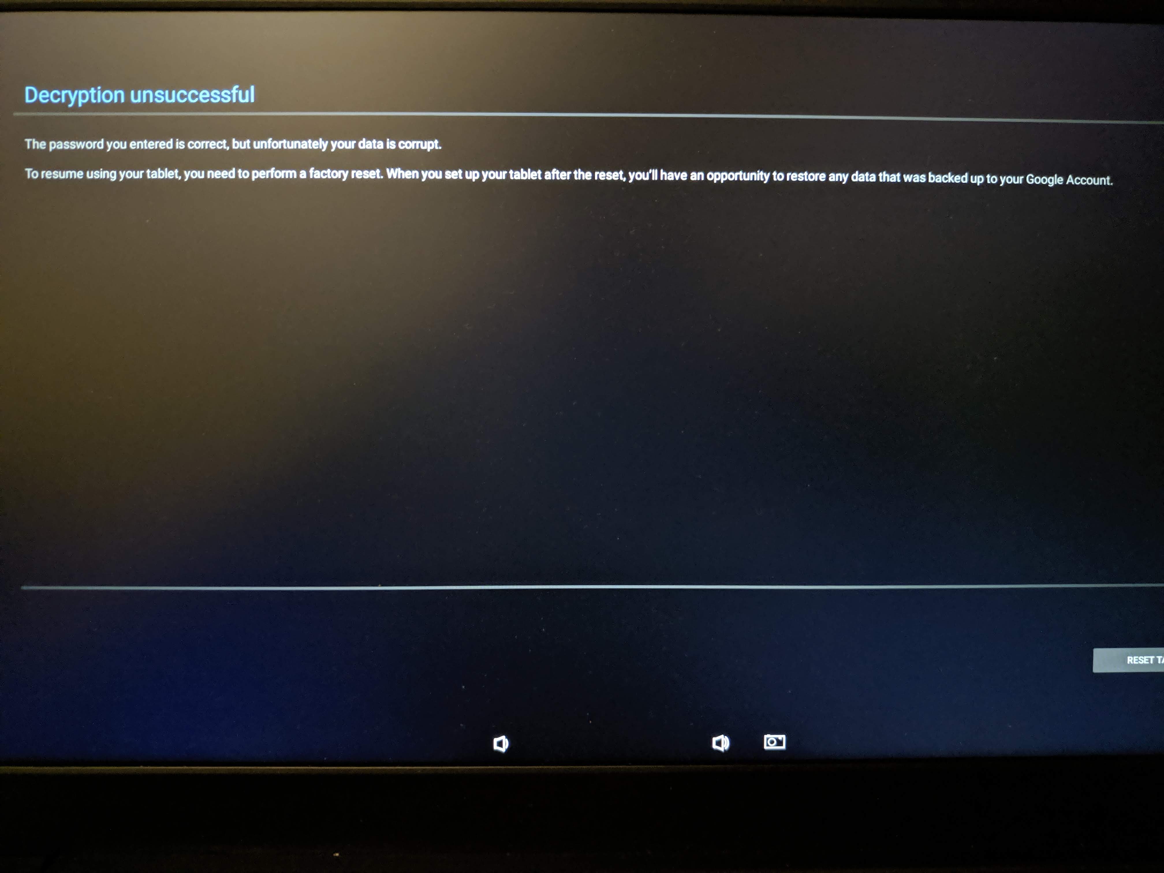

What I found out myself is:
- My sandisk extreme micro SD cards won't boot or will get stuck on a "dead android" logo boot loop (but others have reported no issues with their sandisk extreme... maybe a different version?)
1) I tried with a cheap 16GB kingston card and it "booted" to an "Erasing" screen, followed by a reboot to the typical "Android" logo boot splash screen, except I never got past that screen, even after 1 hour it was stuck there.
2) After forcing a shutdown from point 1) I pulled the SD card and plugged it back in my main computer where I used testdisk to recover the GPT partition table, four partitions were detected. I've mounted all of them, One of those needed to be fsck'ed.
3) Then I tried again to boot the SD card and this time after a couple of minutes I got an actual Android login prompt, where I used the password "rock" but then got a message saying that my "data" (partition) is corrupt and cannot be decrypted, inviting me to press "factory reset", so I did.
.jpg   IMG_20200130_185336.jpg (Size: 276 KB / Downloads: 742)
